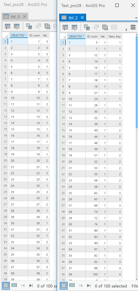

Open the table and compare the before and after.
Have fun with NumPy and Arcpy
