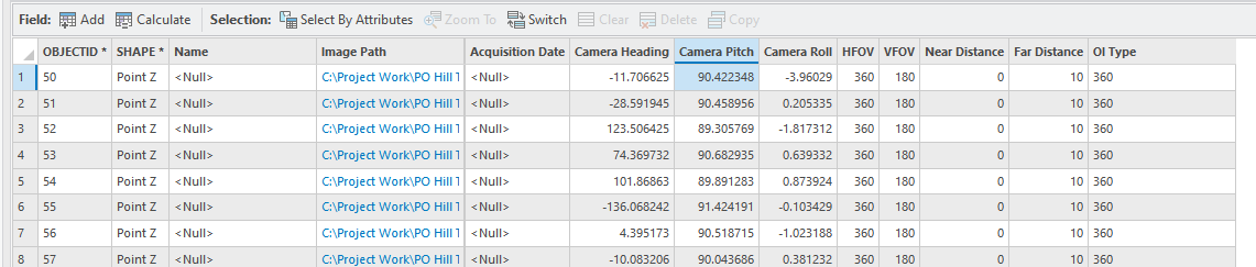

I'm trying the OID catalogue out with some 360 imagery and I'm getting the following errors when I try and publish them with the Generate Service tool.
ERROR 000892: Horizontal Field of View - The numeric value is outside of the valid range.
I'm not sure why this is happening as the 360 imagery should be set to 360 and that is what is specified in the documentation.
JamesHead-Mears1
This was a bug and has been solved in ArcGIS Pro 3.2.2 update. https://support.esri.com/en-us/bug/BUG-000168863
