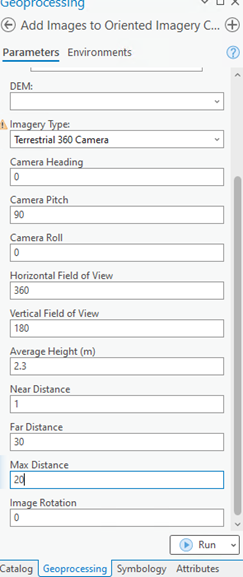

I have 360 images(Taken from a camera mounted on top of a car) and a Frame Table with ( X,Y,Z, SRS, Image, Name, Omega, Phi, Kappa) values. I created OIC and added the images using the frame table and filling the parameters as shown below.

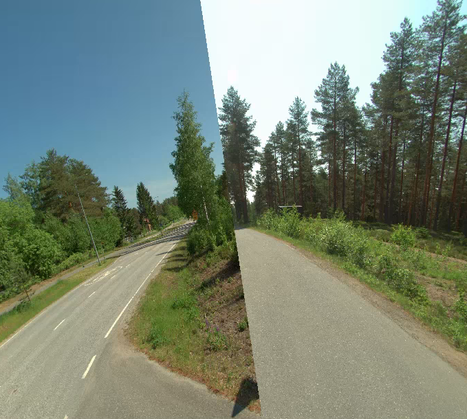

When displaying the images in the oriented imagery viewer, the images are not showing the entire 360 view.

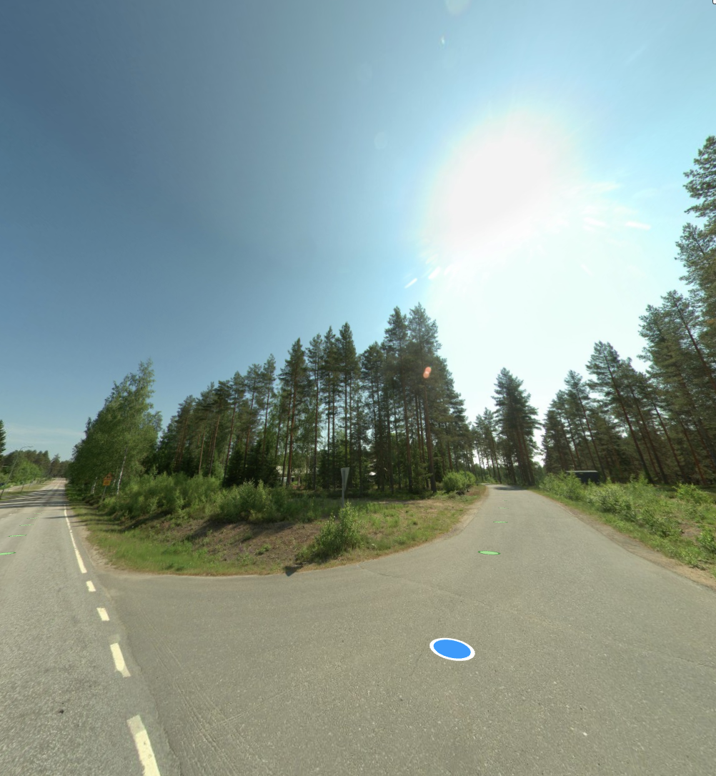

1. I checked if the images correctly show 360 view with another viewer and YES they do. So there is no problem with the images. here is a screenshot of the same image in another viewer

3. I tested with different parameter values of the Camera Heading, Pitch and Roll and Nearest and Farthest distances Values. But these didn't fix it.
4. I created OIC for another data and location and the Stitching problem is still there.
Can someone please help me figure out how to fix this?

It looks like there is some kind of problem with ArcGIS pro Oriented Imagery Viewer! I just created an experience builder app with the same Oriented imagery catalog and the Viewer correctly displays the entire 360 degree view.
