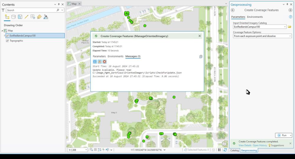

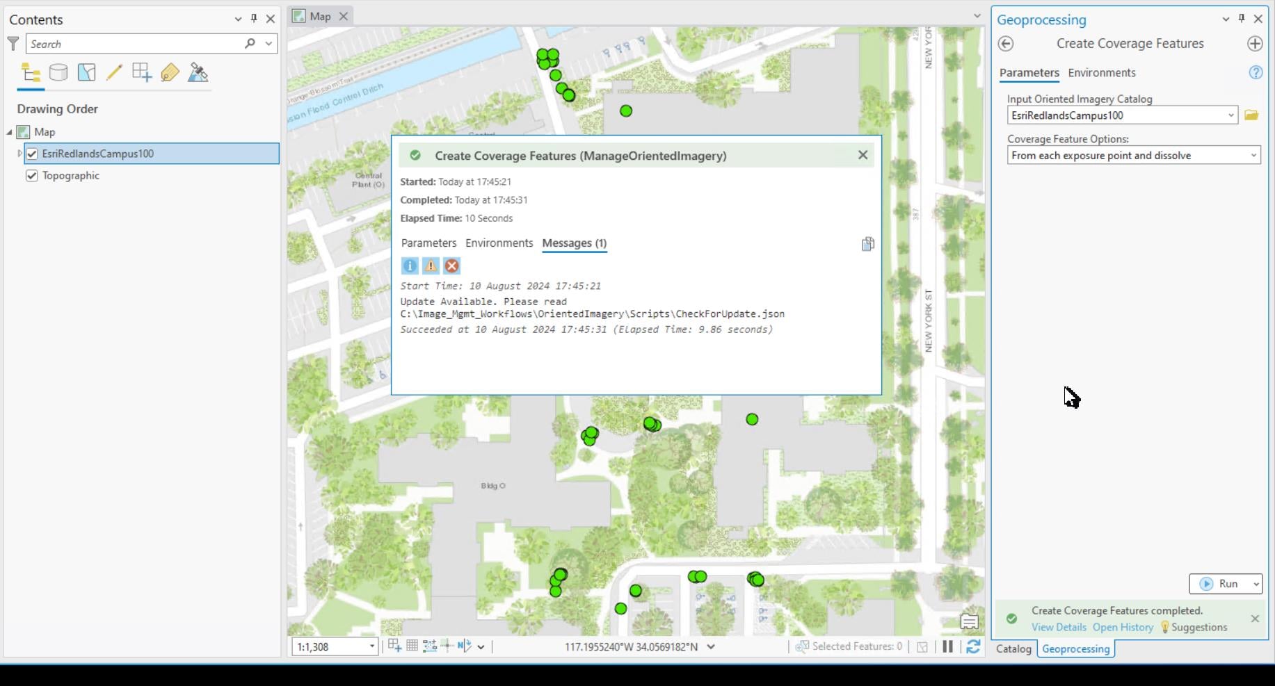

Greetings All,
When I go through the Tutorial in Create an oriented imagery catalog Tutorial, I am getting stuck in step 4. when running the Create Coverage Features GP tool.  The tool completes successfully, but no polygons are created. When I view the details, I get the following message: Update Available. Please read...
I am using the ArcGIS Pro Addin for ArcGIS Pro 3.3, with ArcGIS Pro 3.3.0.
with the Oriented Imagery Classic Management Tools for ArcGIS Pro  Version 2.16 (Released February 2024)
Is there a new version of the tools, and if so, does anyone know where I could get it from?

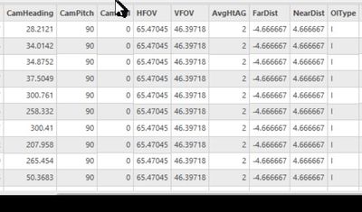

Yes, I have all the values filled in:
I have tried the above with Pro 3.2.0 and the corresponding tools and the same with Pro 3.3.0. Both yielded the same problem.
