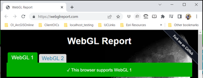

Can you please open this link.
You should see a report like this..
Open this link in your chrome browser or any other browser.  if you can send me the report. I suspect that webGL may not be supported on your machine.

Hi Randall,
Thanks for your email.
I checked with both Chrome and Edge and it says WebGL is compatible with both.
It seems the issue is with the oriented imagary browser within ArcGIS Pro itself.  I'm not sure if ArcGIS Pro has its own internal browswer or if it uses another browser installed on my machine though.
