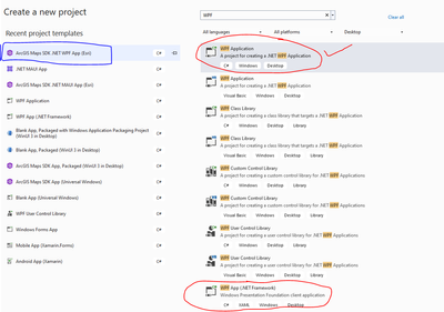

PreetiMaske
For WPF , you can create two types of application : WPF using .NET Framework or WPF using .NET. These are two different frameworks for creating a WPF app. I was suggesting to create a WPF application targeting .NET.
Red circled ones are Microsoft's template for 1) WPF .NET and 2) WPF using .NET Framework. I was suggesting to use either the Maps SDK template( highlighted in blue) or the one I checked in image below.
Blue is ArcGIS Maps SDK template for WPF .NET
SDK templates can be installed from within Visual Studio. See https://developers.arcgis.com/net/install-and-set-up/#install-the-visual-studio-project-templates-op... for more info.
