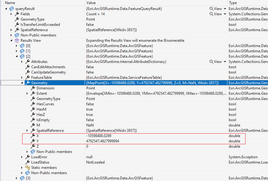

I'm trying to query a feature layer that I got added succesfully into a map.
My program is very much like that of the sample program on ESRI tutorial page, query a map feature layer: https://developers.arcgis.com/net/query/tutorials/query-a-feature-layer-sql/
I'm not using the sample's provided parcel endpoint, I've supplied my own feature service REST API endpoint.
The query went through and returned about some hundred of points. The issue is I can't seem to grab the X and Y even though they are shown clearly in the debug window under Geometry. Only a handful of properties such as HasM, HasZ, HasCurves shown up in the context menu/visual-studio IntelliSense.
I couldn't help but am thinking this may be a known bug ? [as it happened to a software vendor our company had before and it didn't get fixed until later version] or am I missing something? Can you please help me straighten this up?
Such a torture I can't extract the coordinates - using a simple foreach loop - knowing they're there.

The feature query returns "Geometry" which is the baseclass of "MapPoint", since it could have been a polygon or polyline. So you first need to cast it to MapPoint:
double tempX = ((MapPoint)feature.Geometry).X;

By default you're getting coordinates in the projection of your map - which is probably WebMercator.
In the query you can set the output spatial reference, by setting the OutSpatialReference on your QueryParameters: https://developers.arcgis.com/net/api-reference/api/net/Esri.ArcGISRuntime/Esri.ArcGISRuntime.Data.Q...
You can also use the GeometryEngine to project coordinates. For instance:
var newGeometry = GeometryEngine.Project(feature.Geometry, SpatialReference.Create(4269));
