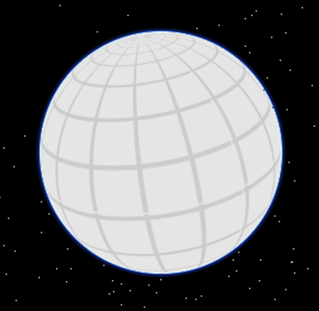

I'm trying to load a Wgs84 based basemap and display it in a SceneView.
For example, trying to use this basemap:  http://services.arcgisonline.com/arcgis/rest/services/ESRI_Imagery_World_2D/MapServer
My code looks like this:
var server = new Uri("http://services.arcgisonline.com/arcgis/rest/services/ESRI_Imagery_World_2D/MapServer");
var sceneLayer = new ArcGISTiledLayer(server);
await sceneLayer.LoadAsync();
myScene = new Scene(new Basemap(sceneLayer));
Yields a blank globe.
This same map loads and displays fine on a MapView.
Also, if I use a WebMercator based map like this:  http://services.arcgisonline.com/arcgis/rest/services/World_Imagery/MapServer
both the MapView and SceneView are fine.
Any help?

We currently only support Web Mercator tiled layers. You can try using this for basemap layer instead: World_Imagery (MapServer)
In XAML
        <esri:SceneView x:Name="MySceneView">
            <esri:Scene>
                <esri:ArcGISTiledLayer Source="http://services.arcgisonline.com/arcgis/rest/services/World_Imagery/MapServer" />
            </esri:Scene>
        </esri:SceneView>
Or in code-behind.
MySceneView.Scene = new Scene(Basemap.CreateImagery());

The ability to use WGS84 basemaps in a Scene/SceneView is on the roadmap for an upcoming release. I'm unable to give a specific date yet.
