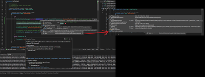

Running the app via the packaging project I get
Esri.ArcGISRuntime.Http.ArcGISWebException: 'Unable to generate token.'
from within
credential = await AuthenticationManager.Current.GenerateCredentialAsync(info.ServiceUri);
If I switch Startup project back to the WPF app, it works fine again.
Using Fiddler I can see that when running via the packaging project, the app is calling /sharing/generateToken without any credentials so that error makes sense. The question is why is it calling that and not presenting the browser window.

I see your point and you were correct. Upon inspection of `AuthenticationManager.Current.Persistence` loaded from CredentialPersistence.CreateDefaultAsync() there was an outdated credential.
Interestingly, RemoveAndRevokeAllCredentialsAsync() threw
'Some credentials could not be revoked (RevokeTokenUrl cannot be null or empty.)'
I could not figure out how to remove it, so I gave
a parameter
CredentialPersistence.CreateDefaultAsync('vik-dev')
to create a new persistence and then it all started working.
