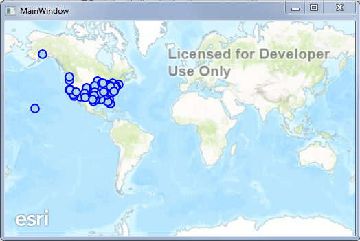

We are having trouble loading FeatureLayers from the code behind.  We based our example on the FeatureLayerHitTesting sample using the following feature layer as a guide:
If we added the feature layer using XAML, the features would show up as expected:

However, if we add the layer using code-behind, the layer would not display.

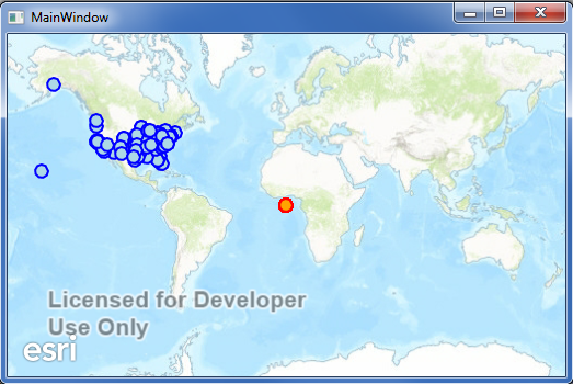

But interestingly enough, we we try to added the same feature layer in both XAML and code behind, the code-behind layer would show up, but with a wrong projection.

Update.  It seems the problem might had to do with the way the ServiceFeatureTable was created.  If I changed the code to use the constructor to obtain the service table instead of using OpenAsync(), it works.  Based on the description, OpenAsync() creates AND initializes the service (most likely in the spatial reference from the service), causing conflict in projection.
      ServiceFeatureTable serviceTable = new ServiceFeatureTable(
        new Uri("http://sampleserver6.arcgisonline.com/arcgis/rest/services/USA/MapServer/0"));
      serviceTable.Where = "pop2000 > 200000";
