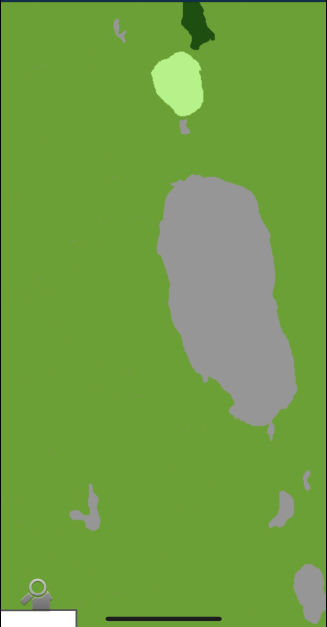

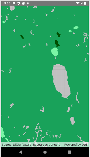

Here are some screenshots of what I'm seeing:
Soil Layer in Android v100.7
Soil Layer in iOS v100.7
by contrast, the soil layer displays correctly in our current version 10.2
Hopefully there's something else I can try to fix this issue. BTW, I don't see any errors happening while executing the new code in v100.7.

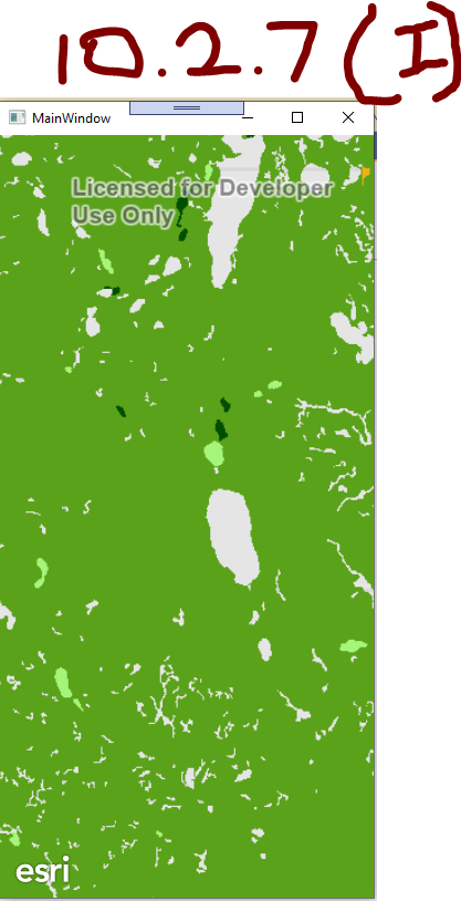

10.2.7 - First image10.2.7 - Second Image100.7 Image
Hector, I don't think what you are seeing is a bug. It is merely a difference in ArcGISTiledlayer rendering at different Lods in two versions.
I can see that at 10.2 the grid lines show up at different scale when compared to 100.7. See First two images for 10.2 above. First one does not show the grid lines but as I zoom in the grid lines start showing up. However in third image which is 100.7, the grid appears much sooner and it is not a bug because there is actually no data in those areas at those levels.
The image you had for 10.2 was on android device and perhaps the background is darker on Android ( I haven't tested that). My test app was a WPF app using 10.2 and 100.7, but it shouldn't matter.
I am almost certain if you zoom in further you will see the grid. It's hard to see the grey grid lines on dark gray. Perhaps there is MapBackground set in your for 10.2 app?
I hope it makes sense. Please let me know if you still have concerns or questions.

You are right Preeti, v 10.2 of our app sets the background to gray and the grid width to 0. Therefore it looks like there's no hole but a gray type of "soil"...
