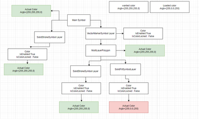

I have a MultiLayerSymbol that is built like this
To Change the color i do the following:
private void Work(MultilayerSymbol symbol, Color color)
   symbol.color = color
   foreach(var symbolLayer in symbol.SymbolLayers)
       if(!symbolLayer is VectorMarkerSymbolLayer vectorMarkerSymbolLayer)) continue;
foreach(var vectorMarkerSymbolElement in vectorMarkerSymbolLayer.VectorMarkerSymbolElements)
           Work(vectorMarkerSymbolElement.Symbol, color)
For some reason the Color property of SolidFillSymbolLayer isnt changing
