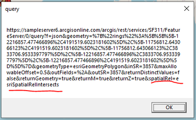

I'm not able to reproduce query sending the wrong spatial relationship on 100.13 and latest. I have the following code based on your query parameters. Could you may be looking at the query made from panning/zooming the map where it needs to get more features in the view extent? I added ArcGISHttpClientHandler.HttpRequestBegin event to interrogate query URL.
public MainWindow()
    InitializeComponent();
    MyMapView.Map = new Map(new Basemap(new OpenStreetMapLayer()));
    MyMapView.Map.OperationalLayers.Add(new FeatureLayer(new Uri("https://sampleserver6.arcgisonline.com/arcgis/rest/services/SF311/FeatureServer/0")));
private async void OnQuery(object sender, RoutedEventArgs e)
    try
        var geometry = await MyMapView.SketchEditor.StartAsync(Esri.ArcGISRuntime.UI.SketchCreationMode.Rectangle, false);
        var query = new QueryParameters() { Geometry = geometry, SpatialRelationship = SpatialRelationship.Intersects, ReturnGeometry =true, OutSpatialReference = MyMapView.Map.SpatialReference, MaxAllowableOffset=0.5 };
        var layer  = MyMapView.Map.OperationalLayers[0] as FeatureLayer;
        ArcGISHttpClientHandler.HttpRequestBegin += (a, b) =>
             if(b.RequestUri?.OriginalString.Contains("/query") == true)
                 MessageBox.Show(b.RequestUri.OriginalString,"query", MessageBoxButton.OK);
        await (layer.FeatureTable as ServiceFeatureTable).QueryFeaturesAsync(query, QueryFeatureFields.LoadAll);
    catch (TaskCanceledException)
    catch(Exception ex)
        MessageBox.Show(ex.Message, ex.GetType().Name, MessageBoxButton.OK);

Thanks, Alex for sharing the issue number. The difference between our repro samples is - the rectangle drawn by SketchEditor is a Polygon type so it remains SpatialRelationship.Intersects in the request. Whereas, if I use the extent of this geometry, an Envelope type, the request issued becomes SpatialRelationship.EnvelopeIntersects. This is by design to accommodate ArcGIS server optimizations available only for Envelope type that is not present in its functionally-equivalent counterpart (SpatialRelationship.Intersects).
