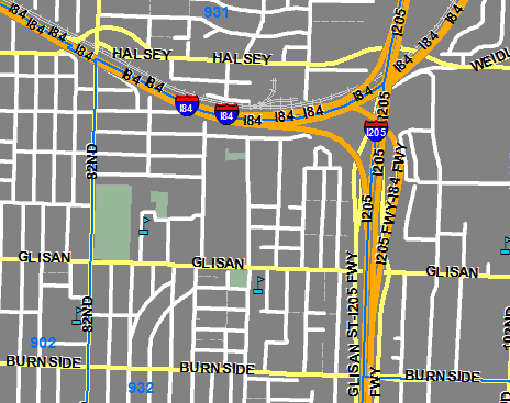

I find that maps rendered from Geodatabase do not look or behave the same way as it looks in ArcMap.  This has been a point of frustration for our customers who are building their runtime content.  I understand that the differences is expected because the map is rendered from two different engines, but the inconsistency and lack of documentation on these differences is frustrating.
Here is a map seen in Arcmap.

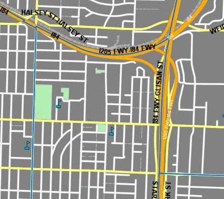

And here is the same map displayed at the same scale in ArcGIS Runtime.
Note the following:
     - The freeway emblem does not show up.
     - The white shadow behind the black text is not there.
     - The label placement property is not observed (I've configured to duplicate labels - one per feature)
Is there any documentation on what is supported and what is not?

Thanks for raising the issue to Esri.  The kind of pain you are going through is exactly what we tried to avoid by providing the known limitations within our documentation.  But unfortunately, we ourselves do not know all the limitations until someone reports it to us or when we stumbled upon it.  It is frustrating at times for sure.

I did notice that in the errors, when attempting to use the Maplex label engine and generate runtime content, that it states that not all label properties are supported in ArcGIS Runtime content (code 24076); to me, this reads that some of it can work. Have you experienced any success at all with the Maplex Label Engine? I already figured out (through trial and error) that label expressions, halos, and shadows are currently deemed "complex", and therefore do not fall into the pervue that is "simple" labeling.
