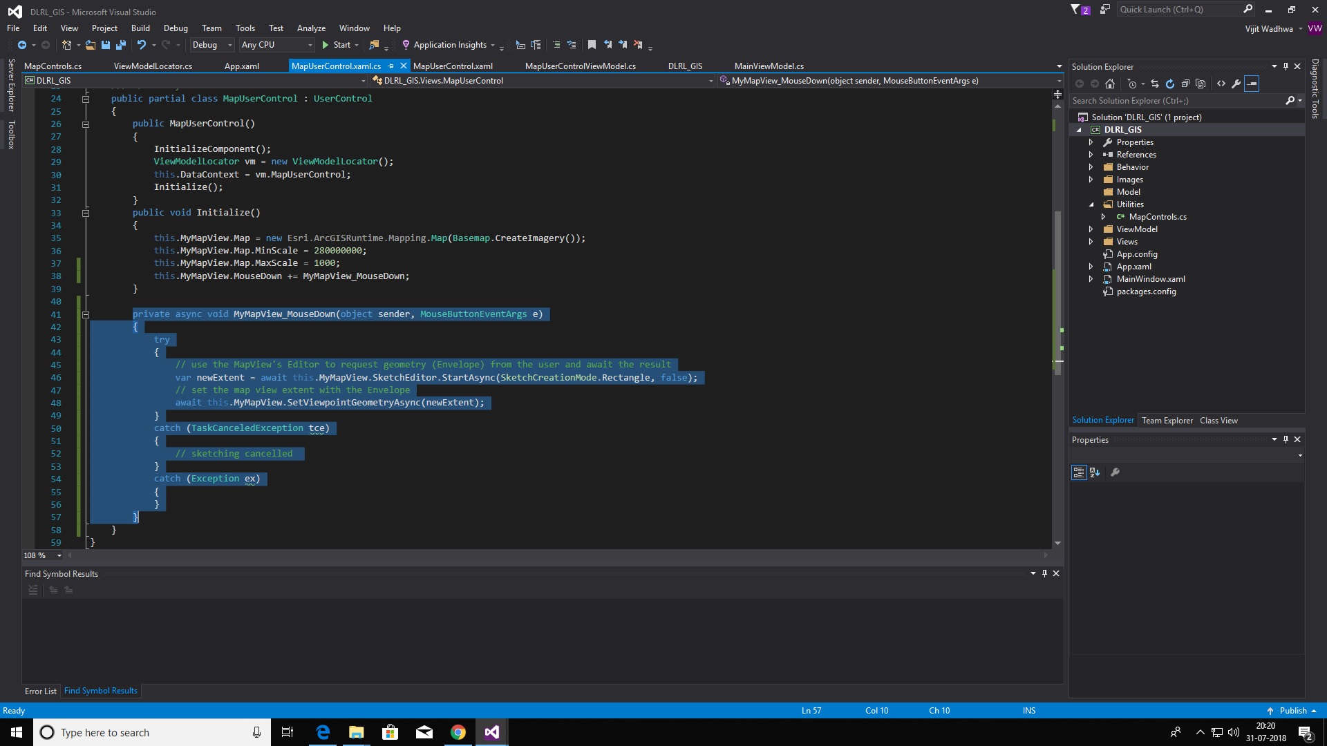

Hi,
I tried to zoom the map by drawing a rectangle on the map (i.e zooming a specific area) , the map zooms to the extent on which rectangle gets drawed, but I am unable to see the rectangle on my screen , I am sharing the code, can anyone tell me , what is my mistake ?
