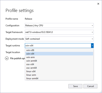

SokoFromNZ
Hi,
I would... if I could... see screenshot
dotMorten_esri
Esri Notable Contributor
Yeah that’s a VS bug. In your project settings add this and it should show:
<RuntimeIdentifiers>win10-x86;win10-x64;win10-arm64</RuntimeIdentifiers>
Or you can manually change it in the publish settings file.
