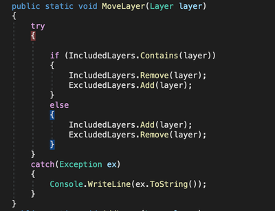

  I have tried the most out of it. Owned doesn't budge.

What collection type are IncludedLayers and ExcludedLayers?
batkaj
only feature type.

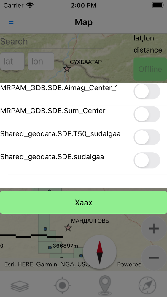

Simulator Screen Shot - iPod touch (7th generation) - 2021-11-09 at 14.00.14.png
dotMorten_esri
Esri Notable Contributor
Is/was the layer already part of a map? It can only be in one layer collection.
If you just need to turn layers on/off like the above screenshot seems to indicate, you can just use the IsVisible property.
