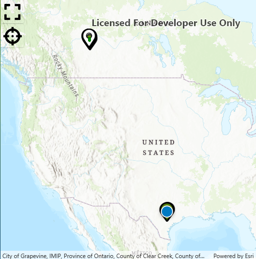

My question is regarding taking an Envelope, or "area of interest" offline. Let's say we have two "areas" in North America that exist. See screenshot below:
Is it possible to take two separate envelopes (one in Canada, one in the US) as the "area of interest" when performing the 'GenerateOfflineMap(GenerateOfflineMapParameters g, string p),' where 'g' contains only one AreaOfInterest defined?
In other words, do I really need one large envelope that includes everything between my two "areas of interest"?
