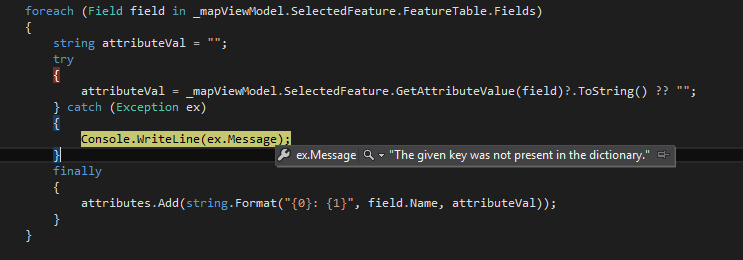

At last, I try to get the attributes of the SelectedFeature by doing this:
As seen in the screenshot, for each field in the feature table of a feature, I tried to get the attribute value of that field, but this triggers an exception, whose message says “the given key was not present in the dictionary.” I was bewildered seeing the field from a feature’s own feature table is not a key in the feature’s attribute dictionary.
What am I doing wrong here? Appreciate any help and thoughts!

Features from SelectFeaturesAsync and QueryFeaturesAsync are usually not loaded unless you pass QueryFeatureFields.LoadAll parameter in QueryFeaturesAsync so by default it would contain the minimal set of fields that are used for rendering the feature. You can use the following code to test using the service Nagma provided.
            try
                var layer = MyMapView.Map.OperationalLayers.FirstOrDefault(l => l is FeatureLayer) as FeatureLayer;
                var query = new QueryParameters() { WhereClause = "typdamage = 'Major'" };
                var result = await ((ServiceFeatureTable)layer.FeatureTable).QueryFeaturesAsync(query, QueryFeatureFields.LoadAll);
                foreach (ArcGISFeature f in result.ToArray())
                    if (f.LoadStatus != LoadStatus.Loaded)
                        await f.LoadAsync();
                    // Update attributes here.
            catch (Exception ex)
                MessageBox.Show(ex.Message, ex.GetType().Name);
You can pass the result of this query to SelectFeatures to mark them selected.
