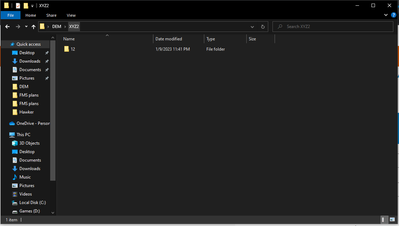

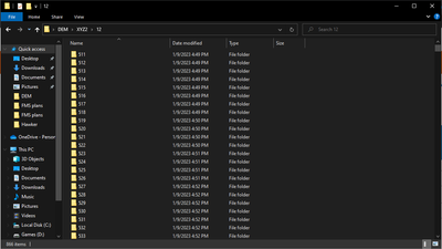

 The main folder has a Subfolder named "12" then in that folder several other folders with numbers which is where the actual PNG images live.
