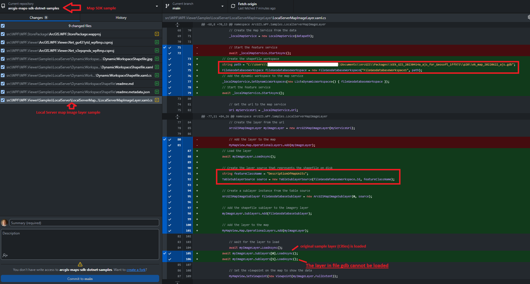

2) Update the "Local Server Image Map Layer"  sample to load the FileGDB as the following
Get the following error at line 106
Esri.ArcGISRuntime.Http.ArcGISWebException
  HResult=0x00000000
  Message=Unable to find the specified 'dataSourceName' in 'dataSource' for dynamic dataLayer with 'id': 0.
  Source=Esri.ArcGISRuntime
  StackTrace:
   at Esri.ArcGISRuntime.Http.HttpDispatcher.<SendAsync>d__14.MoveNext()
   at Esri.ArcGISRuntime.Internal.RequestHandler.<IssueRequestAndRespond>d__4.MoveNext()
   at ArcGIS.WPF.Samples.LocalServerMapImageLayer.LocalServerMapImageLayer.<Initialize>d__2.MoveNext() in D:\others\arcgis-maps-sdk-dotnet-samples\src\WPF\WPF.Viewer\Samples\LocalServer\LocalServerMapImageLayer\LocalServerMapImageLayer.xaml.cs:line 125
  This exception was originally thrown at this call stack:
    [External Code]
    ArcGIS.WPF.Samples.LocalServerMapImageLayer.LocalServerMapImageLayer.Initialize() in LocalServerMapImageLayer.xaml.cs
