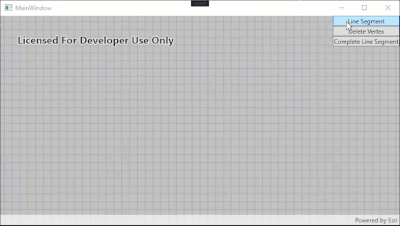

You can try the following simplified sample that contains the MapView with GraphicsOverlay for displaying the new geometry and some buttons that Start/Stop/DeleteVertex on GeometryEditor.
Using the PropertyChanged event of the GeometryEditor, you can check its Geometry and update its VertexTool properties. The PolylineBuilder's IsSketchValid currently checks the minimum required number of points for a polyline so having two unique points is considered valid.
Per Shelly's recommendation, if you want to continue to edit the geometry, you can use the Tools' InteractionConfiguration to enable/disable which vertex editing is allowed. For example, disable new vertex creation.

  1. Click Line Segment button to start drawing
  2. Click Delete Vertex button to remove selected vertex
  3. Click Complete Line Segment button to stop drawing.
  4. Notice in this small sample code, vertex creation is only allowed when you have not met the minimum 2 points.
