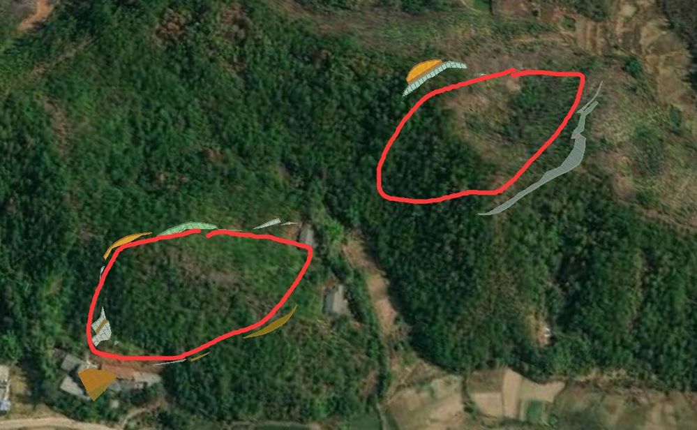

The scene layer (.slpk file) contains subgrade mode which partially below the surface.
I want to ceate holes on the surface to make the subgrade mode visible when viewing from above.

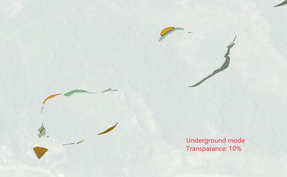

I have tried this way but it didn't solve my problem. I want to make the surface partially transparent ( e.g. by given  a polygon) , so the model which partially under the surface (as shown in Figure 2) can be visible totally when viewing from above.
Is there a way to cut a hole in the terrain surface or make the terrain surface in the specified region transparent?

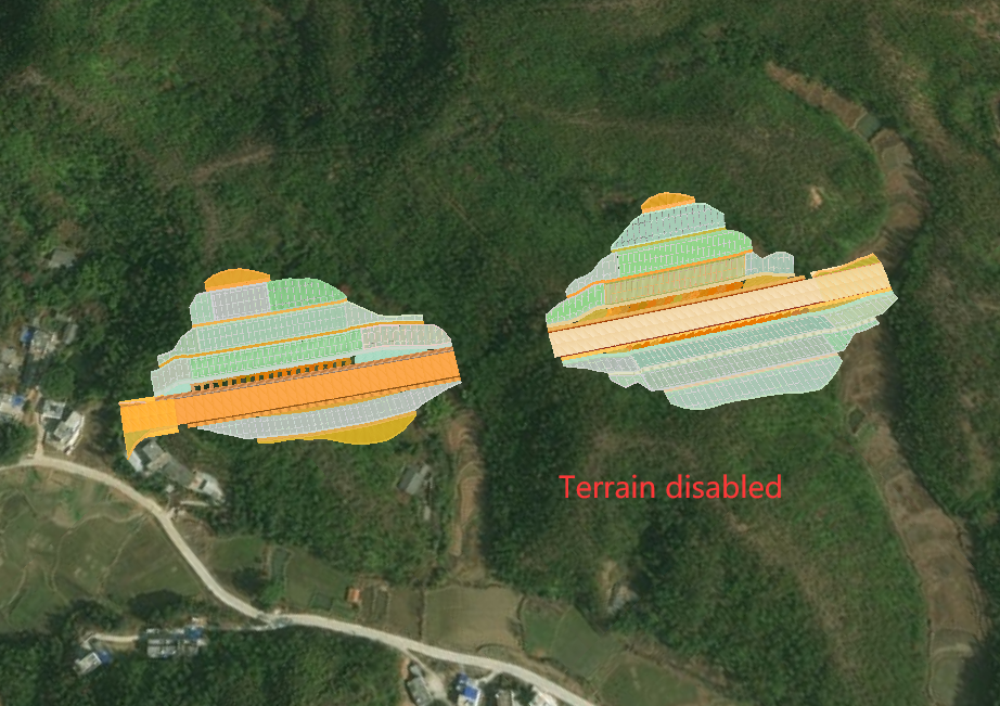

I have seen this sample, but can't meet my needs.
As shown in Figure 3, the subgrade mode can not be visible when camera stay above the surface
