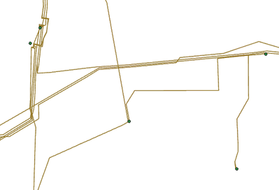

I have a dataset consisting of lines (>11,000 features) and points (>2500) that intersect those lines. See a sample of what this data might look like:
I want to be able to calculate the distance traversed from any given point feature along a line feature, respecting direction. So, essentially, what's the point on "brown" line feature that is x distance away from "green" point that intersects with this line?
