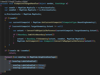

After some more digging around, I found that the issue was the following code executing every time the user zoomed in:
That for each loop was causing the labels to enable themselves - I'm not sure what purpose it serves but that's been resolved.
