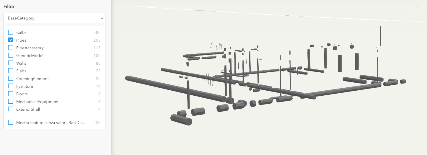

Hello community,
I'm working on a 3D Object SceneLayer by .NET Maps SDK for Maui platform (200 version).
On my enterprise platform I have a published scene with one 3D Object SceneLayer where I can filter the elements on a single layer with the web viewer.
If I go in the properties of the layer I can create a filter on a field and make some objects visible or not like in the picture below:
I would like d to reproduce this behaviour on a mobile app, but when I load the 3D Object SceneLayer in my SceneViewer it's impossibile to make any filters.
Furthermore the FeatureTable property of the layer is always null.
Is there a strategy or a way to load a 3D Object SceneLayer in my SceneViewer and make some filters to show or hide elements in the layer?
Is possible that I am not able to create filter on 3D Object SceneLayer by the .NET Maps SDK?
Thanks for the support!
KoushikHajra
Hello @simone-vitale-overit,
Thank you for reaching out to us with your question. Unfortunately, filtering on a 3D Object Scenelayer is not supported at the moment in Maps SDK. We have plans to support it soon in a future release at which point, you would be able to create filters and apply them on any 3D Object Scenelayer.

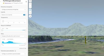

FermínVargas
 Hi Koushik, I also want to do many filters in a 3D scene layer in argis online. Hopefully soon the 3D scene will have the ability to do it.

FermínVargas
Gracias KoushikHajra, pero no soy desarrollador. Quiero filtrar cualquier dato (tabla de atributos) contenido en la escena de capas de arcgis online..
