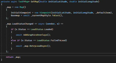

Here is the code we use to create the Esri map:

I’m sorry to hear you’re seeing problems with Map display. It is hard to tell for certain what is going on without seeing the full code, but I do have some ideas based on what you’ve shared.
  • The InitialViewpoint property is mostly intended for use in situations where a map is being opened from a Portal item. In cases involving programmatic creation of maps, it is preferred to set the viewpoint on the MapView directly. Setting the viewpoint after the map loads should be more reliable.
  • What is happening in the _currentMapStyle.ToEsri()? Consider trying to await the basemap creation, using the basemap as a constructor parameter for the map, and then setting the InitialViewpoint on the map. My hunch is that maybe in the process of applying the basemap, is resetting the initial viewpoint.
  • You might also consider waiting for the map to load before returning the map, to rule out any timing issues.
I see in the video that the map appears to be moving in the cases where the viewpoint successfully loads. Are you using a LocationDisplay or LocationDataSource to navigate the map based on device location after the map is displayed?

  • Are you saying to set the Viewpoint after a successful MapLoaded status is returned?
  • Our app makes use of Esri maps and Google maps so we have an internal enum to manage the different map types between the two platforms.  The _currentMapStyle.ToEsri method is a mapping function from an internal enum value to the associated Esri Basemap.
  • I've been wondering if there was a timing element to this problem.  It will take me some work to change the return of the map for that but that makes a lot of sense to me.
Thanks much for your suggestions!

Yes, ideally viewpoint should be set after the map is added to the MapView. That may require a small amount of refactoring to break this code into two parts, one to create the map, another to call `mapView.SetViewpoint` or `mapView.SetViewpointAsync`. Alternatively, you might be able to follow the pattern in `AddGraphicsOverlays` to interact with the MapView.
Since the GetMap is already an async Task, you should be able to insert `await _map.LoadAsync` before returning the map. That will ensure the map is loaded before it is added to the map. If you explicitly load the map by calling `_map.LoadAsync` before returning, you can then check `_map.LoadStatus` rather than setting up an event. Although if you are already making the change to calling SetViewpoint on the MapView, then you should only need the explicit loading step if you want to do error handling.
Updated code might look something like the following:
try
    var basemap = await _currentMapStyle.ToEsri();
    _map = new Map(basemap);
    await _map.LoadAsync();
    _mapView.Map = _map; // Or alternatively do this in a separate method
    AddGraphicsOverlays();
    await _mapView.SetViewpointAsync(initialLatitude, initialLongitude, _defaultZoom);
catch //... error handling - explicit loading of map should throw exceptions that you can catch
