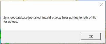

I am using ArcGIS runtime SDK for .NET 100.5 to develop a WPF application. I am using this sample code https://developers.arcgis.com/net/latest/wpf/guide/sync-offline-edits.htm to synchronize the *.geodatabase. Most of time, it has been working well, but one of my users failed to sync his data today. He got an error message below:
I guess that this error was caused by the large offline geodatabase (*.geodatabase), but I am not sure. Does anyone have any idea about this error? This user’s offline geodatabase (*.geodatabase) is over 2GB. Is 2GB a large size for a offline geodatabase? Is there a size limit for a offline geodatabase (*.geodatabase) to do synchronization? Our feature service is running on ESRI ArcGIS online.

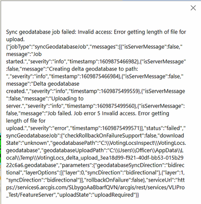

What you can do when the job fails to call job.ToJson() and log this.  This is a lot of the communication between server and client during the sync and may give more information.  As the message may not mean a whole lot

I called job.ToJson() when the job failed and got the following message. It looks like that delta database had been created, but uploading it was failed, right? The length of delta database file has an error, doesn't it? How can I fix it? Thanks for your help and Happy New Year!

Thanks for your reply. I reported this issue to ESRI support and finally they gave me an answer. Please see the answer below:
"I've been doing a bit more digging into this issue, and found that the file size limit here is being imposed not directly by the Sync operation, but by the File Upload operation . From the docs:
By default, each service or its extension has a predefined list of allowed file types and a maximum file size. This limit also applies to files uploaded using feature service add or update attachment operations. By default, ArcGIS Server imposes a 2 GB limit on the maximum size of file that can be uploaded
By extent, this affects syncing with a feature service, which uses the Uploads endpoint to upload the replica."
