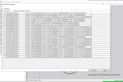

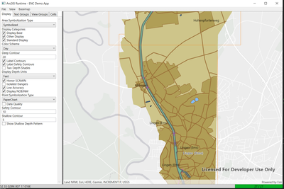

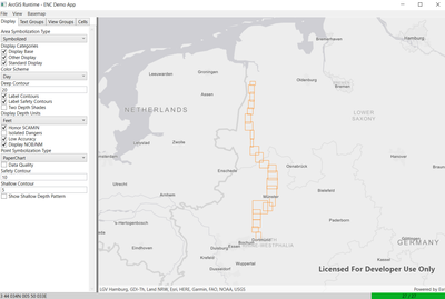

HydroExpert
Hello,
These charts are Inland ENC (IENC) and apparently not supported by ArcGIS Runtime.
I was able to view them with an older version (100.2).
Use this demo app: https://github.com/Esri/arcgis-runtime-demos-dotnet/tree/main/src/HydrographicsSample
HydroExpert_0-1650639779592.pngHydroExpert_1-1650639836410.pngHydroExpert_2-1650639894705.png
However, ArcGIS Runtime versions after 100.2 will not load IENC data.
