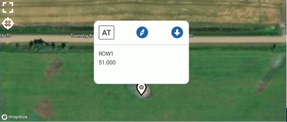

Below is a screenshot of a Callout in Mapbox, that I am trying recreate something similar here:

I am interested in overriding the 'ControlTemplate', so I can present my own custom Callout, similar to what I was able to accomplish using Mapbox (reference above screenshot).
I have looked at the newest ArcGIS.Samples.Maui demo, but can only find samples of using a Callout with simple string parameters in the CalloutDefinition (the 'text' and 'detailText').
Is the type of custom callout from Mapbox possible to create using the MVVM pattern in MAUI?
