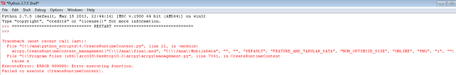

I need to automate the process of creating runtime geodatabase. I have a working model which use the Create Runtime Content tool. It works without any errors.
I exported this model to python script and it failed to execute.
So I tried to run that model from toolbox by using arcpy.ImportToolbox and it still wouldn't execute.
If I just copy this line arcpy.CreateRuntimeContent_management("C:\\Jana\\final.mxd", "C:\\Jana\\MobileData", "", "", "DEFAULT", "FEATURE_AND_TABULAR_DATA", "NON_OPTIMIZE_SIZE", "ONLINE", "PNG", "1", "") into python window in ArcCatalog it worked fine without any errors.

I can see that you're running your code against the 64-bit install of python. I'd be curious to find out if your code works against the 32-bit install of python. I won't be able to test this against the 64-bit install until Monday, but everything works fine on my machine.

Hi Freddie,
You’re right.
I have installed pywin32 (32 bit) and it works. It also works in pyscripter but I needed pywin to be able to automate it in task scheduler.
Thanks a lot.

In task scheduler are you explicitly setting the 32 bit python executable to run your script or are you using the default for the system? I would highly suggest that you explicitly set the python executable if your default isn't the 32bit instance. I'm assuming the default on your machine is the 64 bit instance.
JanaPfefferova
Deactivated User
I'm explicitly setting the 32 bit python to run it. It didn't work with the default 64 bit instance.
