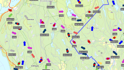

I need to merge multiple symbols into one, with rotation and changed color based on feature/graphics attributes. I am using this on a GraphicsOverlay.
A basic example from ArcGIS pro
Using the same Dictionary Style in ArcGIS Map SDK for .NET. They all use the default color of the symbol defined in ArcGIS Pro.
Rotation and hide/show different symbols based on graphics attributes work, however, the color does not want to change based on attribute value, with the important part

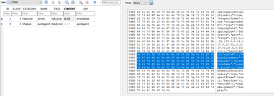

In the style there is a symbol with the primitiveName 'layers_arrow' of which I would like to change the color. using FillColor or Color has no effect in ArcGIS Map SDK for .NET, but it does work in ArcGIS Pro.

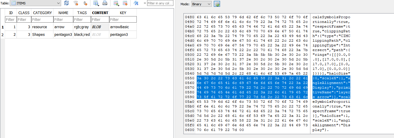

The relevant section from DB Browser for SQLite. Interestingly, the name layer arrow is visible in the binary display of the arrowBasic content

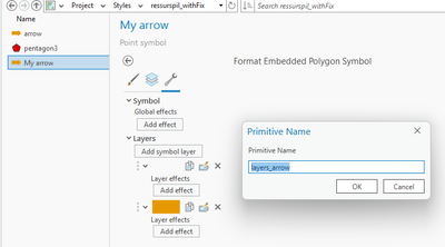

Hi,
My reply is purely based on looking at the symbol json and the stylx files. I have a good guess what might be happening.
I think the issue is the where in the symbol structure the "layers_arrow" primitiveName is placed.
When I view the symbol structure for the arrow in the ressurspil.stylx, I see that the "layers_arrow" primitiveName is at the marker graphic layer.  As you  mentioned, this is working in Pro but I have a suspicion that it might not be working in Native Maps SDK because most likely it is something we are missing support for.
For now, To override the color you can move the primitiveName to the CIMSolidFill of the embedded polygon symbol.  When the primitive override is placed at this level the name used will be property name of Color and not FillColor which is only used for at the marker graphic level.
I am attaching an updated stylx file with a new symbol called `My arrow`. Could you please try with this symbol and see if it works for you.
Thanks,
Preeti

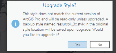

I'm @BjørnarSundsbø1 's colleague doing the PRO part of this. We got the stylx you tweaked to work in both PRO and SDK, but I don't see how I can "move the primitiveName to the CIMSolidFill of the embedded polygon symbol."
I can see that layers_arrow is no longer set on graphic layer
I don't however see where (in PRO) it is placed now. Can you please explain where/how in PRO you have placed the label  layers_arrow in order to place it on the "CIMSolidFill of the embedded polygon symbol" ?
Thanks! Regards,
Erik
I'm btw on Pro 3.2.0 and had to upgrade your style in order to open it (if that's related).

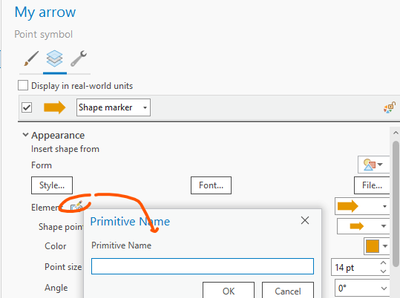

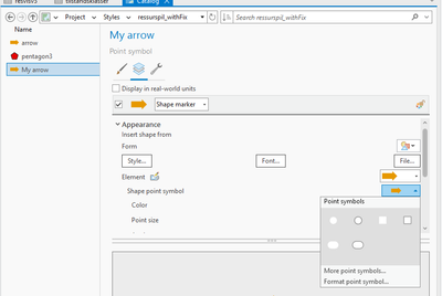

hesmebye
You really have to dig down into the settings 🙂
First you select
"Format point symbol" in the menu abowe.
Then the dialog changes slightly
Then you select "Format polygon symbol" in the menu below
Then you get to the right "level" and select the "Structure of the symbol" and you get the label for the solid fill available
Then you can set the label 🙂  - kind of nested thing...
ErikScavenius
Thanks @hesmebye . The procedure challenges my definition of user-friendliness, but it works and opens up great flexibility. Great (and appreciated) step-by-step illustrations 🙂
