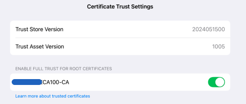

  • I have added the root certificate to the simulator and it is trusted

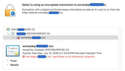

My thought is that there may be a problem because the certificates life is more than 2 years, which I think Apple does not like.  On my development Mac once I put the Root CA in Keychain connecting to the ArcGIS Enterprise from Chrome was fine, but from Safari you get trust issues because the length of the certificate.  I do not know if there is a may to override this.  It will be quite an effort to change the certificates life so if there is something to try before that I would love to find what that is.

JoeHershman
MVP Alum
No way in code to do the 'Trust Anyway' type thing one might do in a browser
Here is what I see in Safari on the Mac.  My understanding is the 'not standards compliant' is because of the Expires date
