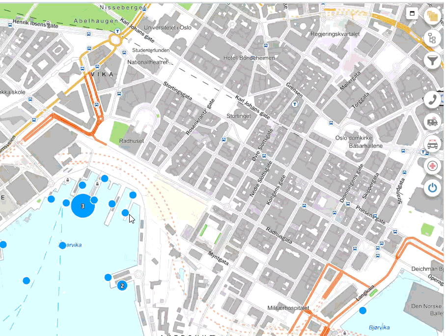

Using ArcGIS Maps SDK for .NET 200.7 and 8 I am having some issues with popups for clustered layers.
I am working with a few clustered layers in a web map from AGE 11.1. They are feature services added to a webmap where clustering and cluster popups are enabled. However, I am unable to display any of the popups for individual features in my client, only the aggregated features.
Is this known behaviour and is there a workaround for this?

If you have both aggregated geoelement and geoelements on the map you will have to tweak your identify code to account for displaying popup in both cases. Properties defined for AggregationFeatureReduction are independent of properties of FeatureLayer.

Thank you for the quick answer. The layer is published to my hosting server and added to my webmap through URL, feature popups and the aggregation  popups are all configured in te webmap settings for the layer. Based on your answer I assume its not possible to inherit both popup properties as the same time, and I need to tweak the identify code to display both. Do you have a sample code for this?
LiveHus
To be more precise: The code accounts for displaying both aggregate results and individual results. When identifying a single feature from the layer, there is no server request intercepted by IHttpMessageInterceptor when clicking individual feature

The code handles displaying popups for AggregateGeoElement or GeoElement. For those layer with only popup for individual features, the popup is displayed. For layers with feature reduction, we get the popup to display for the reduction and also to get information on the individual features as part of the reduction. However, when attempting to identify individual features (not aggregated) in the layer with aggregation, there is nothing. Not even a request to the feature layer to query the feature the user clicks on.
