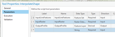

Models are fine, but typically as your usage gets more advanced, you'll want to switch to Python scripts. I've shared an old example below. This uses a Linear Referencing tool as well, to add the distance along the line for each point (which I displayed in a client-side chart when you hover the mouse over). I would then add this Python script to a Toolbox and setup the input/output parameters (see image further below).
e.g.
import arcpy, math
inputLine = arcpy.GetParameterAsText(0)
inputRaster = arcpy.GetParameterAsText(1)
outputShapeZ = "in_memory\\outShapeZ"
outputShapeM = "in_memory\\outShapeM"
arcpy.ddd.InterpolateShape(inputRaster, inputLine, outputShapeZ)
arcpy.CreateRoutes_lr(outputShapeZ, "ident", outputShapeM, "LENGTH")
arcpy.SetParameterAsText(2, outputShapeM)
Thanks
