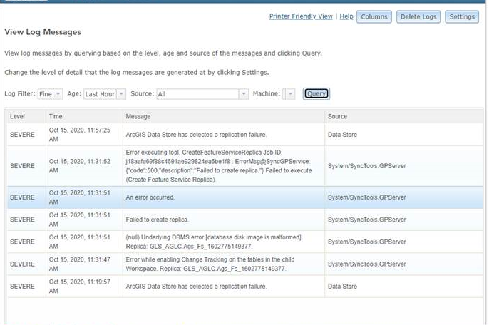

PalakPandey
Hi Joe, Yes I went through the log at server end which shows 'ArcGIS Data Store has detected a replication failure'  and alss 'Underlying DBMS [disk image is malformed]'. But I am using the same db for offline map generation in geocortex and other places. Everything works fine.
