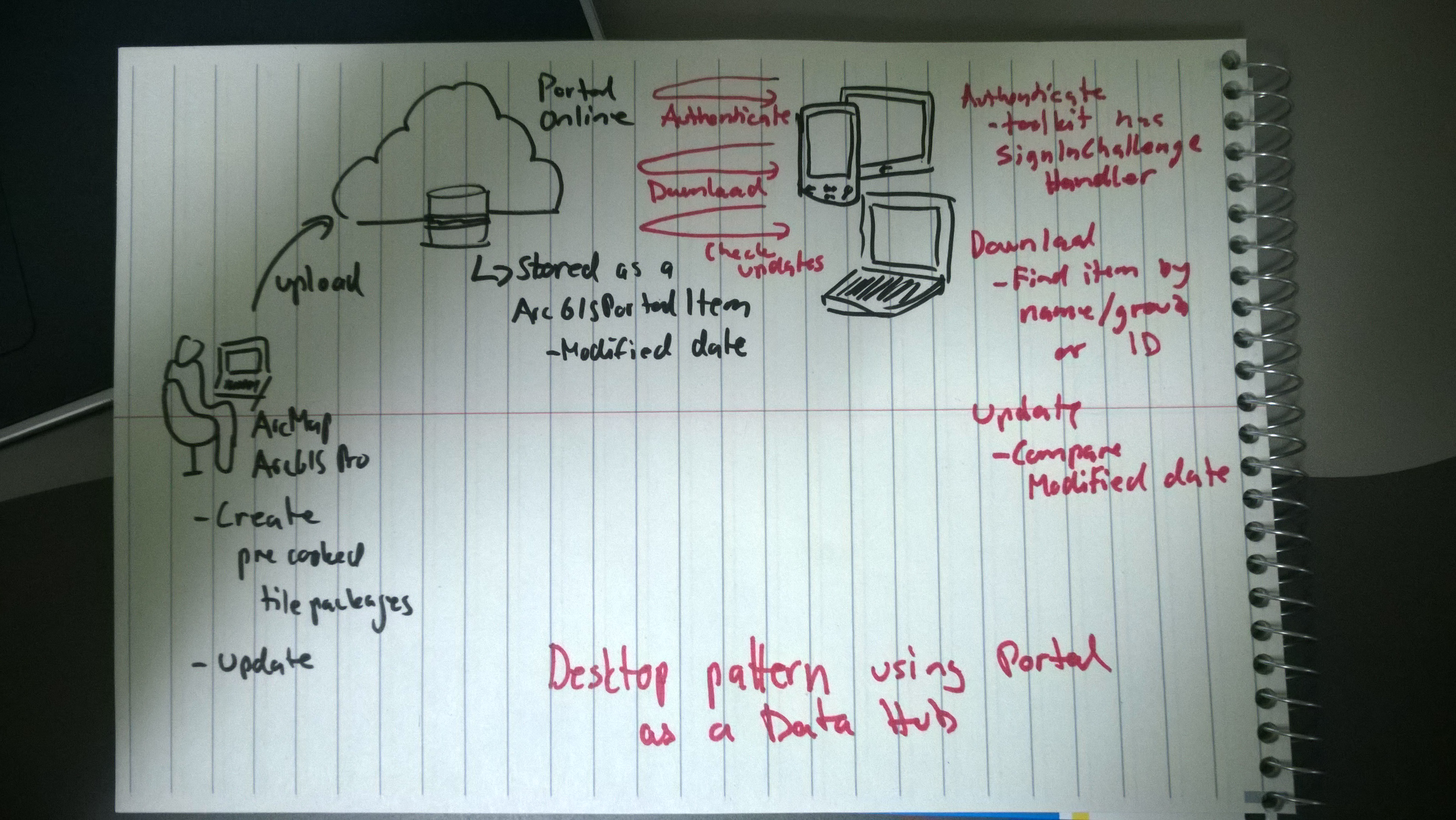

Could you define the workflow that you have been thinking for managing the data in the WindowsPhone? How the data is delivered into the device, how it's used and managed in the application?
From platform point of view, using ArcGIS Portal or ArcGIS Online as a data hub works very well to deliver data dynamically to your applications, provides easy way to distribute updates and help to unlock Standard licensing (you can take the application offline for 30 days by signing into the portal/online and saving the token to the device - no need for separate deployment license).
I drew a simple chart of this that might clarify it this a bit. Basically you can deliver any data to the your applications this way and you can implement some data being automatically downloaded, some on request basis and you can control who has access to what data. Data can be uploaded to the portal manually or you can automatize it if needed so process vice you have a lot of options.
I talked this approach in DevSummit this year and you can find recording from here ArcGIS Runtime SDK for .NET: Transitioning to It from Other Esri .NET SDKs | Esri Video and sharing data section starts around 24:50. Code can be downloaded from http://www.arcgis.com/home/item.html?id=865907613bdd4f1bae1f0537f5a48d84
