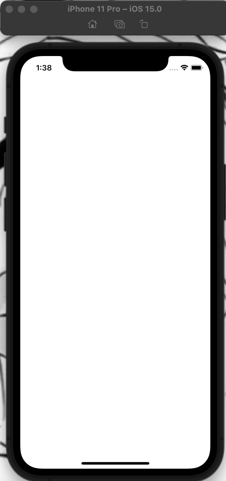

Hi team we are referring this simple map display sample:

Attached screenshot of the blank app loading
Any help would be appreciated

Did you set the ApiKey? The basemap you're using requires that to be set.
https://developers.arcgis.com/documentation/mapping-apis-and-services/security/#api-keyshttps://deve...
Otherwise try Basemap.CreateImagery() which uses a non-metered service.
