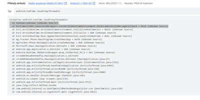

TomášZachoval
Is there any progress? Or a workaround? Users are complaining that they can't launch the app and I don't really know how to proceed.
Thank you for your help.

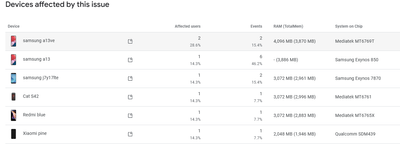

GKmieliauskas
Our clients have the same issue with ArcGIS Runtime 200.6
Samsung Galaxy A13 Android 14 (SDK 34)
Application works with online basemap created at startup.

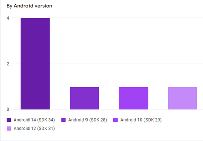

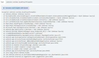

I would like to share our Android app vitals of last release (21of March 2025). About 30% of crashes are related to RuntimeCoreNet.GeneratedWrappers.CoreArcGISRuntimeEnvironment.SetArcadeConsoleMessageCallback. How could we speed up the solution to this issue? Can we expect a solution with the 200.7 version?

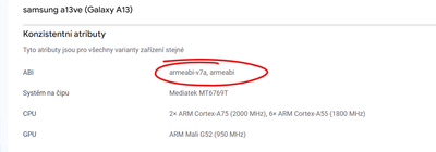

TomášZachoval
Hi, I have version 200.6 and problem is probably still there.
TomášZachoval
It is the same on this Samsung. It's on this phone too if that helps. But it's the same ver ABI. Just for information.
