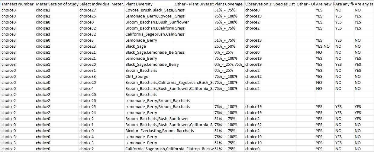

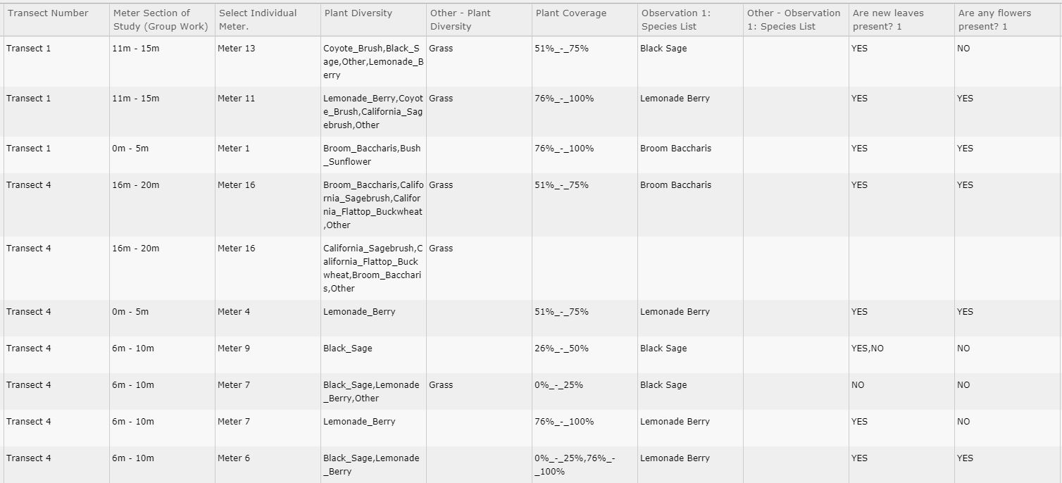

I created a Survey123 survey for a group of students to use collecting data on plant biodiversity. The app worked well in the field and the results look great on the Survey123 website. However, when I export the data-set from the website in Excel, some of the fields are changed. For example, I have some drop-down menus and when exported show "option2, option11, option21" as opposed to the view on the webpage of the plant name.
I used the webdesign feature (drag & drop) and didn't build the survey in excel. Is there a way to change this in my survey or on the back-end?
Here are some examples: Survey123 Web View
Exported i Excel View:
