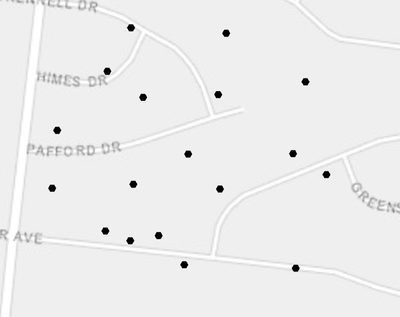

For example, here are some observations (or "nests") as black hexagons:

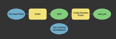

I take these and use them as an input for a buffer (set to output a single polygon) and then run random points using that buffer as my extent constraint. Here is a picture of what the model might look like:
