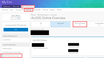

Did you check in your My Esri account (My Organizations > Licensing > License Information > ArcGIS Online Information), if the ArcGIS Online subscription is activated or not? If the license is not yet activated, you can activate it again.
Let us know if you still facing challenge in activating your AGOL organizational account.
You may also reach out to your locl Esri Support (Communication details in "Support" tab of My Esri > My Organizations).

Thank you for your post, I have already talk with a technical support assistant and he drive me through the solution, it was an account management issue and now I have a unified account between Esri and ArcGIS online. Anyway, your solution help me a lot to understand what was going on. Thank you so much again.
