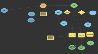

My Model:
Here i loaded the WebMap from my Organisation Portal "Grundkarte Zeichentool" in my ArcGIS Pro Project. And use it as InputMap for "iterate Layer". This works fine. If i do not load the WebMap in my local ArcGIS Project and load it directly from the Portal the InputMap will not be accepted (Input Portalelement).

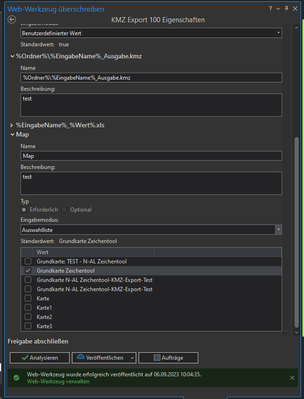

Publish as WebTool:
In the publish process as Web Tool, in the Content Configuration Menu i see all my Maps of my current ArcGIS Pro Projects. And i selected "Grundkarte Zeichentool" as default value for the InputMap. This is the Web Map from my ArcGIS Portal that i loaded in my Project and is also the Map i use in my WebApp, there my Widget should be executed.

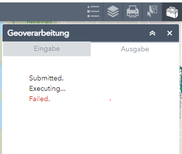

Error after executing the Widget:
After executing the Widget this error showed up. In the ArcGIS Server Manager i can see what happend in the Logs:
The Log says the required Input, the Map Value, is empty. I think it makes sense, because the Input Map is the Map of my local ArcGIS Project and the Portal does not know this local Map.
