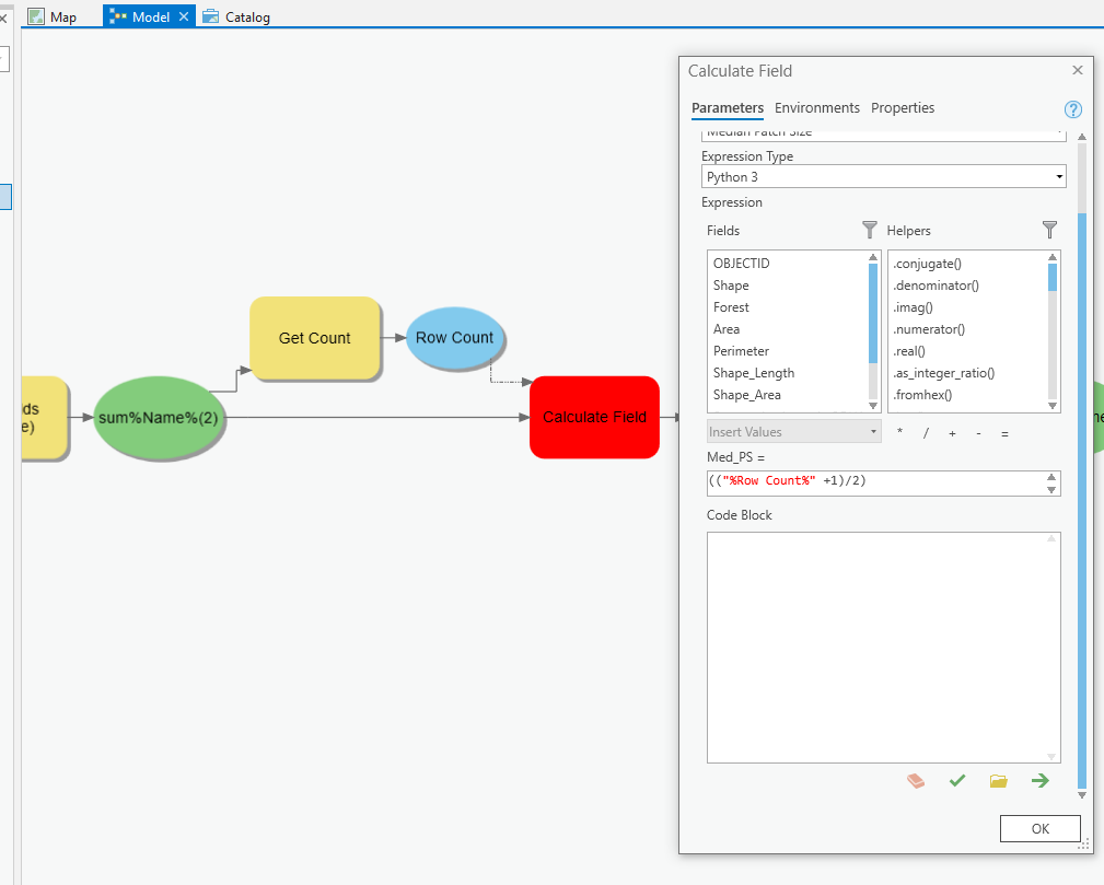

Hello,
Trying to figure out how to use the Get Count Tool as a variable and to use it in a field calculator expression. Tried to use inline variable substitution but it is not working properly and giving me an error related to string/interger. The Row Count is set as a precondition. Attached is a photo for reference. any advice would be well appreciated!

Can you try without the quotations around Row Count
LeahFulton
Tried without the quotations and it only works without any other numbers in the box

I have spoofed up a similar situation as shown below.
If I attempt to validate the expression I get a Syntax Error as shown above.
If I IGNORE that error message and run the model it runs without error!
