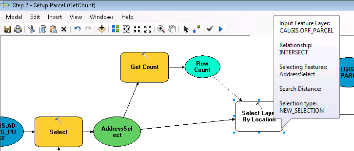

I think I'm having some trouble understanding how to make use of Get Count. I have the following:
What I want to see happen is if Row Count = 0 > End the model. If Row Count > 0 continue the model. What I see is when Row Count > 0 the model continues and when Row Count = 0 it just seems to spin it's wheels for a bit (30 seconds) then end. I don't know if maybe it has something to do with Select Layer By Location using AddressSelect as it's Selecting Features? Or maybe I'm just using Get Count completely wrong and there's a different way I should be approaching this.
Thanks for the help,
Chris

The output of the Get Count tool is of type integer, which when it has the value of zero is interpreted as false when linked to the next tool in the chain as a precondition.  This can cause problems when you want the tool to continue when the count is zero. In situations like that you are better off running the Get Count inside a Python function (arcpy.GetCount_management(lyr)) in the Calculate Value tool (that is, hiding the results from the Model Builder) and returning true or false as Boolean based on the Get Count result.
