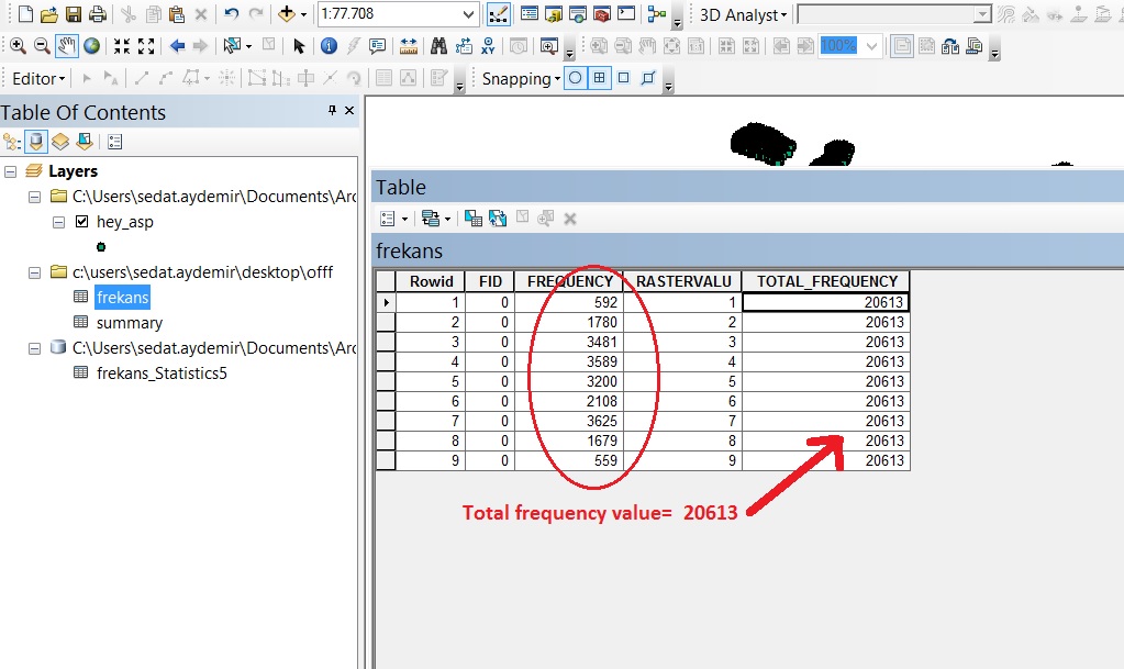

I wrote the TOTAL_FREQUENCY values for all rows manually. But I want to  write this values automatically with a script, toolbox or different way. Namely, I want to write sum of column 3 value to all of the the column 5 rows. How can I do it with a script, toolbox or different way automatically?  Please help me....

1. Right click on Frequency field > Statistics > Note the sum value of Frequency.
2. Right click on Total_Frequency Field > Field Calculator > Type sum value and Enter

Yes I know that, but I will use this implementation in model builder, so your method is not automatically, a little manually.
