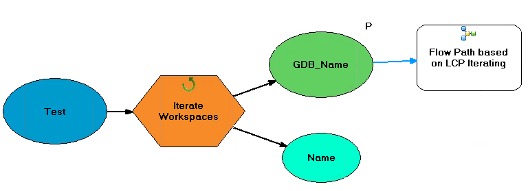

I am processing a large set of data to do least cost path analysis from a lot of point sources.  To speed things up I am chopping up all of the source data into a series of geodatabases.  My LCP model iterates through each point in the gdb and solves the path.
What I want to do is iterate through the gdbs (244 No.) and store the results just in that gdb (I'll put the data back together later).  I may just be being a bit dim, but I can't work out how to pass the name of the current workspace into my sub-model for it to pick up the inputs it needs.
I have exposed my sub-model inputs so that they show up in my main model,
And made them like this,
But this clearly isn't correct as it doesn't validate.  If I run just the iterator in the main model and then set these inputs manually to exactly the same as above (but don't validate it), the sub-model does run for the last workspace.
I've thought about simplifying it so that I only need to get my first input parameters from the main model and can then get the workspace for this in the sub-model, and whilst this would look neater but I still have the same initial problem of getting the workspace variable into that parameter.
I suspect I am missing something really obvious!!

So the Parameter from your sub-model called PathResults is used as a workspace in the sub-model? If you want to use the current workspace that the iterator is spitting out then you need only type into PathResults the inline substitution %Workspace%. Currently it appears you have the output of the iterator as a precondition to your sub-model (dashed line), you do not need that.

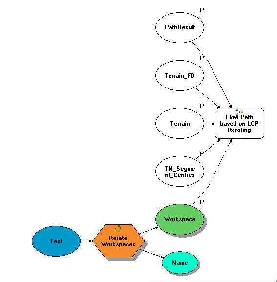

I have tried to simplify this, but still not quite got it working.
I have created a Workspace variable in my sub-model as a Parameter and referred everything else in that model to %workspace%
If I add the sub-model to the main model I can connect the Iterator output to it as Workspace.  If my main model has already been run (so the GDB_Name has a value) before I add in the sub-model, it is all OK, and the sub-model will run, but obviously only on the last Workspace the iterator found.
If I then Validate the main model, if breaks the sub-model.  Is this because there is no longer a value in GDB_Name to act as the Workspace variable for the sub-model?  If so, how do I get around this?  I still think I'm missing something blindingly obvious!!
Simon
DuncanHornby
MVP Notable Contributor
In your original model the iterator is creating an output named Workspace so you use %Workpace% to pass this value into the sub model parameter. You have now renamed that to GDB_Name so to pass that you would use %GDB_Name% as that is what you are now calling it. Worth reading the Help file on inline substitution.

This is what the start of the sub model looks like…..

This is a "feature" of Model Builder that validating an iterator breaks its output. I suggest getting it all ready to go and then do not validate, just run it.
When the validating system totally keeps me from getting things done, I have worked around it by running the submodel in a Python script inside Calculate Value.  (Import toolbox, pass parameters to the model tool, return result with data type set). Yes, painful, but sometimes worth not going all the way to a full Python script.
Just a suggestion: %workspace% is a built-in model variable that references the current environment workspace. You should use another variable name that will not conflict, like "Working GDB"

In your sub-model you have created a variable called workspace and exposed it as a parameter but it is not connected to anything in your model, so will do nothing. The other variable (tm_segment_centers) which is connected to the iterator is not exposed as a parameter so won't get exposed to the master model. Suggest you delete the variable workspace and make the input to the iterator the parameter.
