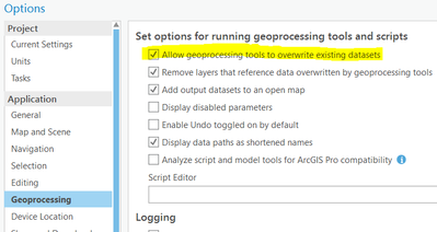

If Curtis' solution is checked, and the issue still persists, then
Check if overwriting existing datasets is checked under Options > Geoprocessing.
