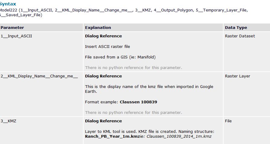

I created a model in ModelBuilder and am adding descriptions for other users. So far I was able to edit the descriptions through ArcCatalog and the explanations in the "Dialog Reference" box are saved (below).

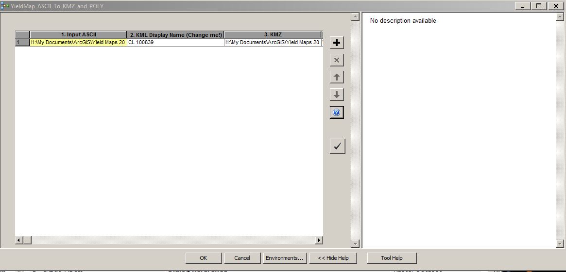

The issue that I have is when I view the model in Batch Mode. I would like to add a description to the sidebar about the selected parameter. I assumed that the Dialog Reference Explanations seen in ArcCatalog would be seen in Batchmode, but it isn't. It states "No description available".
I am trying to make this model extremely user-friendly, and I think the descriptions in the sidepanel would be great! I am just stuck on how to get there.
How do you add the description? Does the Dialog Reference relate to the sidebar description?

Thanks for the quick reply. I am aware of this dialog. As shown in the first image, I have typed the description for each parameter. My question is why the description of each parameter shows up as "unavailable" in the Batch Mode option (second picture), when I have filled in the information.

DavidBlanchard
Unfortunately, parameter descriptions do not show up in the batch window. To see the description, double click the input box to open the parameter window. This window will display the description for that parameter.
