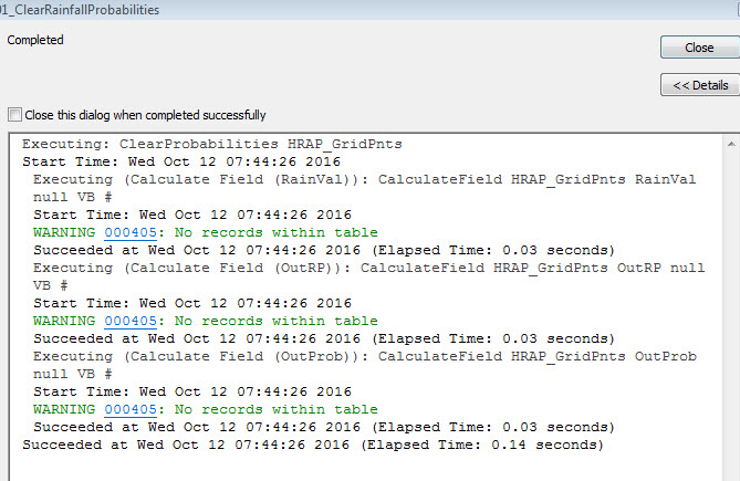

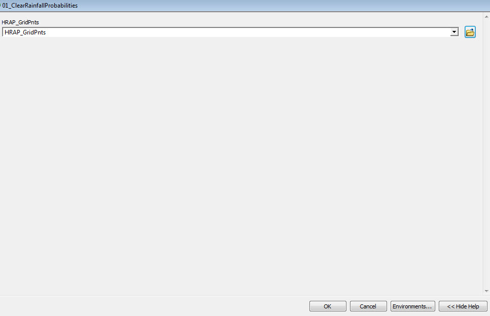

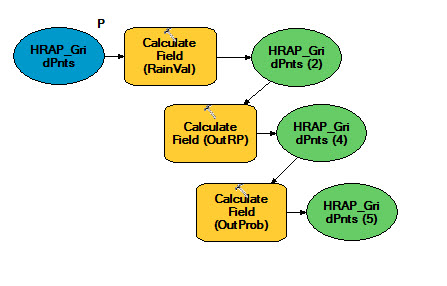

I have been having increasing issues model builder that utilizes model parameters as inputs and feature layers in an existing ArcMap table of contents.  I models run successfully for a while, but then if I change the underlying input layers at all (even if if has no impact on the model process), it acts flaky.  For example, I have a simple model that simply calculates three fields in an existing feature class that I have loaded in ArcMap.  The input feature layer is exposed as parameter, but I have a default value set.  It worked fine may times, but now when I run it, I get a message that there are no records in the table (even though there are).  To make it work now, instead of using default or picking from list of ArcMap TOC items, I have to point the input to the feature class by loading the feature class directly in the tool interface (i.e. hitting the little folder icon and navigating to the where feature class is stored).  If I do that it works fine. he attached images show the simple model, model interface, and message I am getting.

I have repro' this behavior totally outside of model builder and have submitted an incident to Esri:
#01848371 ArcMap Tools do not recognize layers after metadata edit session
UPDATE: bug recorded (ArcGIS 10.4.1 [all data types] and ArcGIS 10.5 pre-release alpha 2 [gdb, not shapefile]
[BUG-000100572: Input drop down choices in geoprocessing tools are not available after editing or saving metadata.]
Here's my script to repro the problem with 10.4.1:
1. Open ArcMap
2. Add feature layer to map
3. Search for Copy Features tool and load dialog
4. Click on input, layers appear in pick list
5. In Catalog window, right click a feature class, open Item Description, Edit, save, exit
6. Search for Copy Features tool and load dialog
7. layers do NOT appear in pick list
8. Save map doc, restart Arcmap
9. Open Copy Features tool
10. Layers appear again in pick list
